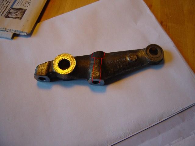

Exmantaa schreef:Those bolts will not fit into the hubs, as the hub bolts are mounted/sunken a few mm into a bore hole of the hubs. You need the CHC types. Ask forum, a Lotus dealer or look on Ebay.co.uk. You see them often under Elise or vx220 parts...
Look what they sell here for the hubs...
http://www.lir-racing.com/catalog/produ ... cts_id=184
http://www.lir-racing.com/catalog/popup ... hp?pID=184
Not gonna fit unless some sort of spacer is used under the bolt head.
If you look at the diagram:
Bolt number 5 is one of those we're talking about?
The bolt head sits in a recessed area in the mounting plinth.
Only an allen-head (or Torx) bolt will fit there.
If a normal hex-head bolt is used it will not sit flush/even as the mounting plinth does not have a flat surface.

Yep, thanks Arno, but I confirm they sell and use these ones without problems on all cars mounted. Eventhough, I will use the Hexagonal one... :wink:
Here a crude sketch how the bolt is recessed in the front hub assembly.
A normal flathead bolt will not fit in there without some spacer bush...
Front hub arm
Front hub arm
hub oic.JPG (29.79 KiB) 2918 keer bekeken

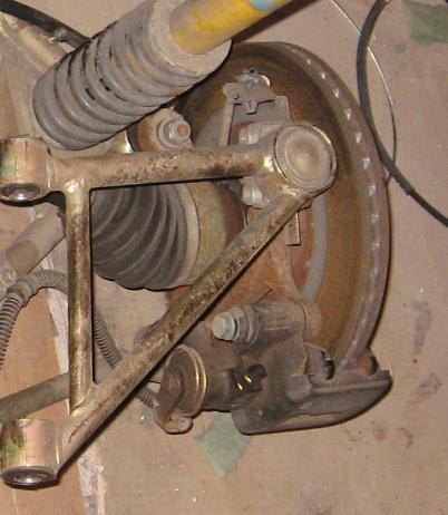

It seems they use the flathead for rear only.
As it looks the rear hub bolts are not recessed, so the flathead bolts should fit there.
Hub rear
Hub rear
Hub rear.JPG (30.64 KiB) 2880 keer bekeken

It seems I need also the hexagonal screws for the rear...
and front
rapidos
Berichten: 367
Bericht door rapidos »
I have got them now. Will fix with 65Nm
