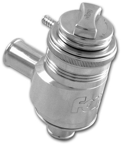

tibby schreef:Forge RS valve ook onderweg.....
The Forge RS valve has been specifically designed and engineered, to offer extreme flow rate capability, where other valves are just not up to it. Often when engines have been tuned by installing larger turbos or even software upgrades improved turbo response can be acheived by fitting the RS valve which has the greater internal mass air flow specification utilising an amazing 50mm (2") bore.
For fine tuning there is a variable spring preload incorporated and a ratchet type top adjuster that will allow for the positive and precise adjustment that your driving style demands. To ease installation a 360 degree adjustable vacuum hose connector
With a choice of inlet and outlet connections the RS valve can be matched to your engine perfectly
This valve incorporates a unique conical, progressive rate spring that can allow for the retention of boost pressure from 7 to 22 PSI depending on the individual user's application and level of adjustment. If you are intending on running over 22psi then you will need the uprated spring FMRSTUN. This unique spring design will also allow for unrestricted piston travel and flow volume regardless of the amount of pre-load adjustment added to the spring. Other manufacturers valves using cylindrical springs with adjustable pre-load often experience restricted piston travel and flow volume within the normal range of valve adjustment.
Gebruikt zoals in Cs z'n k16 set up (en een hele hoop andere duitse turbo's)
Vergelijk Synapse vs Forge RS
Beetje teleurgesteld eigenlijk over de Forge. De Forge toont immense ivm de Synapse. Bij de Forge heb je nog zo'n voorhistorisch kliksysteem om de veer aan te spannen wat de helft van de valve in beslag neemt. Qua inhoud zijn beide hetzelfde. De Synapse is echt wel meer vooruit....
Maargoed, meten is weten. :yes:
